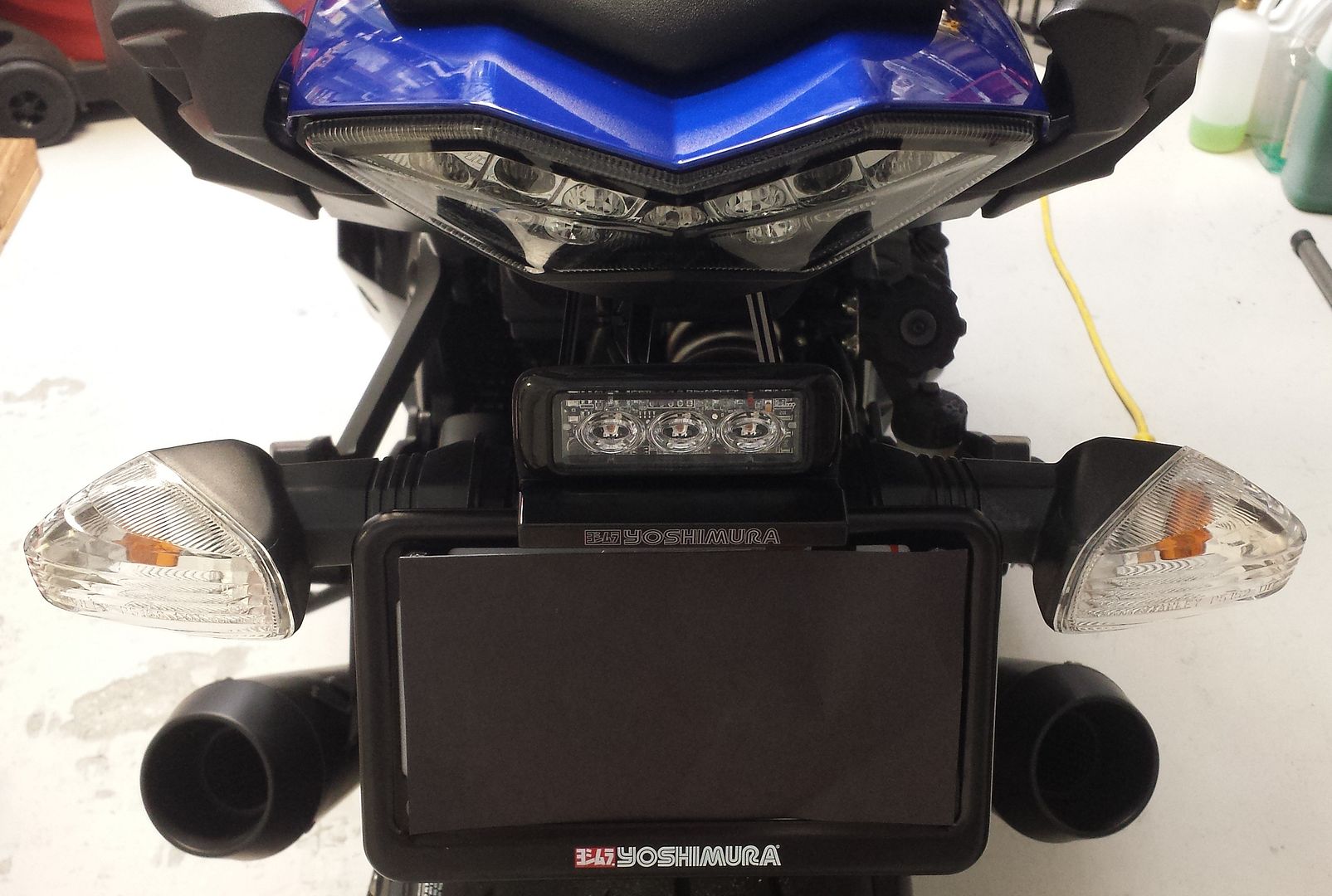

I also installed the Yoshimura Fender Eliminator Kit. Like some had mentioned, it did take some time but the kit is good quality and the fit is excellent. BTW, the Kawasaki side bags fit fine with this kit. The pic below should give a good idea of the finished product.
Also, if you're wondering, the 3 LED Strobe brake light mounted above the tag is one I got from West Chatham Warning Devices in Lexington, SC. It's a very bright and programmable flashing brake light that should get anyone's attention coming up from behind. I did have to fabricate a mounting bracket but it's an easy job and fastens using 4mm X 0.7 X 10mm long screws that hold the tag light in place. Here is a pic of it all:
Anyone interested in ordering the brake light can contact Denise at West Chatham via e-mail: [email protected]. Just ask for the new 3-LED ultra low profile flashing brake light. I believe the price is $65.
