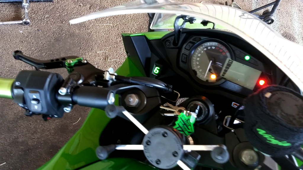

I Got it and it works. I recommend getting a 1 in. arm. The 3 inch is a bit much in my opinion.Anyone try this on 2014 N1K? I took out the plug on the bike and it has a hexed opening versus a smooth round bore. Do you think this would still work? I just want to mount my iPhone there for GPS and to see who is calling.

Awesome! Stays nice and tight? I will be using an iPhone 5 on it with a small bracket that holds the phone. So mass is minimal.I Got it and it works. I recommend getting a 1 in. arm. The 3 inch is a bit much in my opinion.![]()

Can you give any tips on how you made it fit?I Got it and it works. I recommend getting a 1 in. arm. The 3 inch is a bit much in my opinion.![]()
I destroyed one of these yesterday trying to get it tight enough not to flop around.. the way the hex hole is I wasn't able to get it all the way into the hole.. do you have it fitting flush with the forkstem or did you use a larger washer and keep it above the nut?
