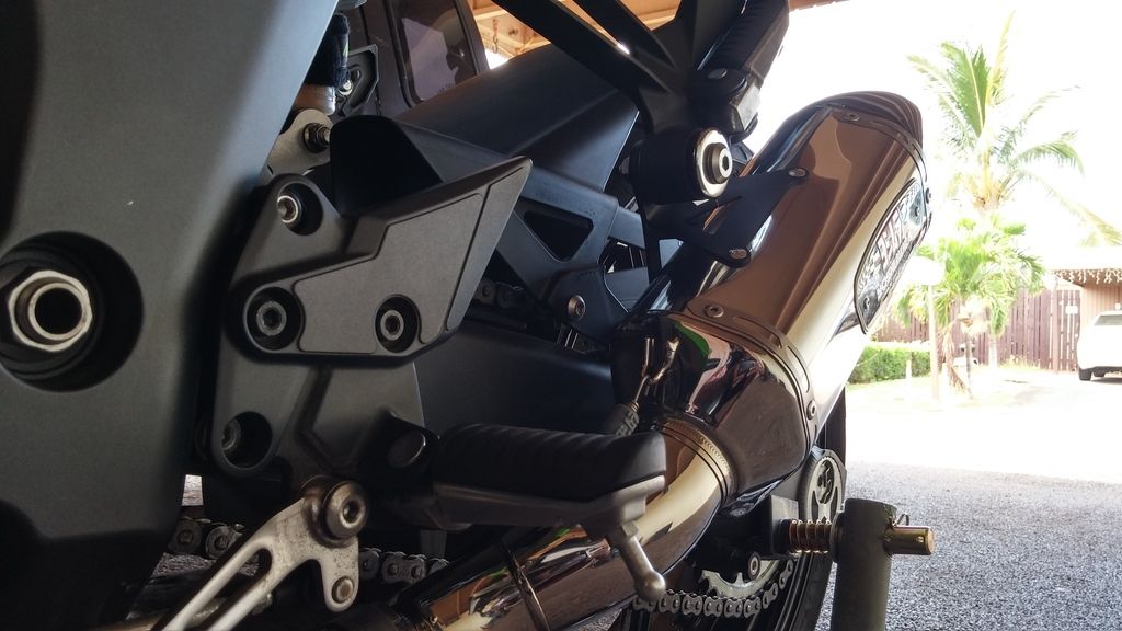

I dont have a decibel pop, so Im thinking, Block off plates not needed. I do want the filter though. But wont if not necessary. Yosh r55 slip ons is what Im running.

Id skip the full system setup. A Slip On will Suffice. But also consider the Brand and the noise that comes with it. My Yoshimuras cost $699.99 But the sound is Not too loud yet effective. A Full System? Way too race for my blood. I like my Quiet time.... Yet the ability to ROAR when needed.So this is why I went Yosh. Had the same Company on my Previous 2008 ZX6R. To each his own, this is just my opinion.
