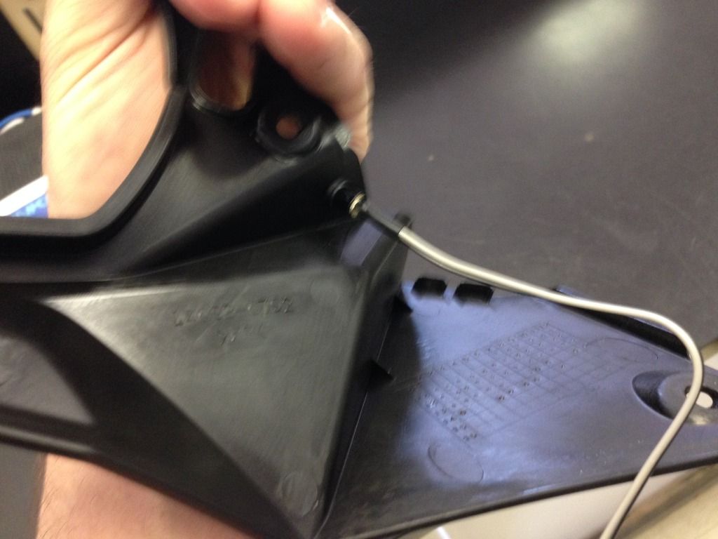

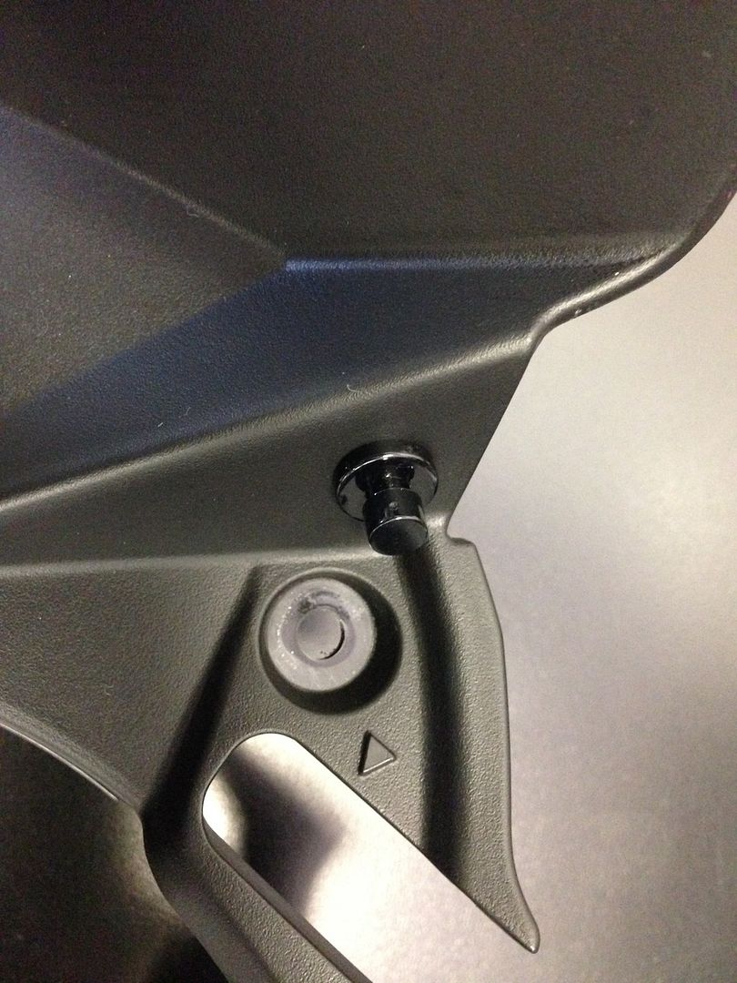

I didn't take as many pictures as I should have but you get the idea. Used a regular about 2x3" opener and used velcro to attach it to the underside of the left fairing. I mounted a small push button switch in the cover that goes around the cluster. I also removed the sticker for the windshield adjuster while I had it off.

Is the circuitboard back in the case?
I put mine in a ziplock bag, and wrapped with electrical tape, to insure no moisture got to it.
wouldn't want rain or anything to get inside...

Great idea. I think I will do the same.

Is there anyway way we can see the images somehow ? I'd be interested to mount something for the door as well.

I was trying to see if I could mount a button in the USB charger 28mm spot. Maybe even use the actual remote, and solder a new button into the circuitry... Well, I'll give it some more thoughts.

Cant see the images,,. Im not clear on how the button triggers the remote, is it hard wired into the remote or wireless?

right click on the images and select open image in new tab if you are using chrome, they come up.
