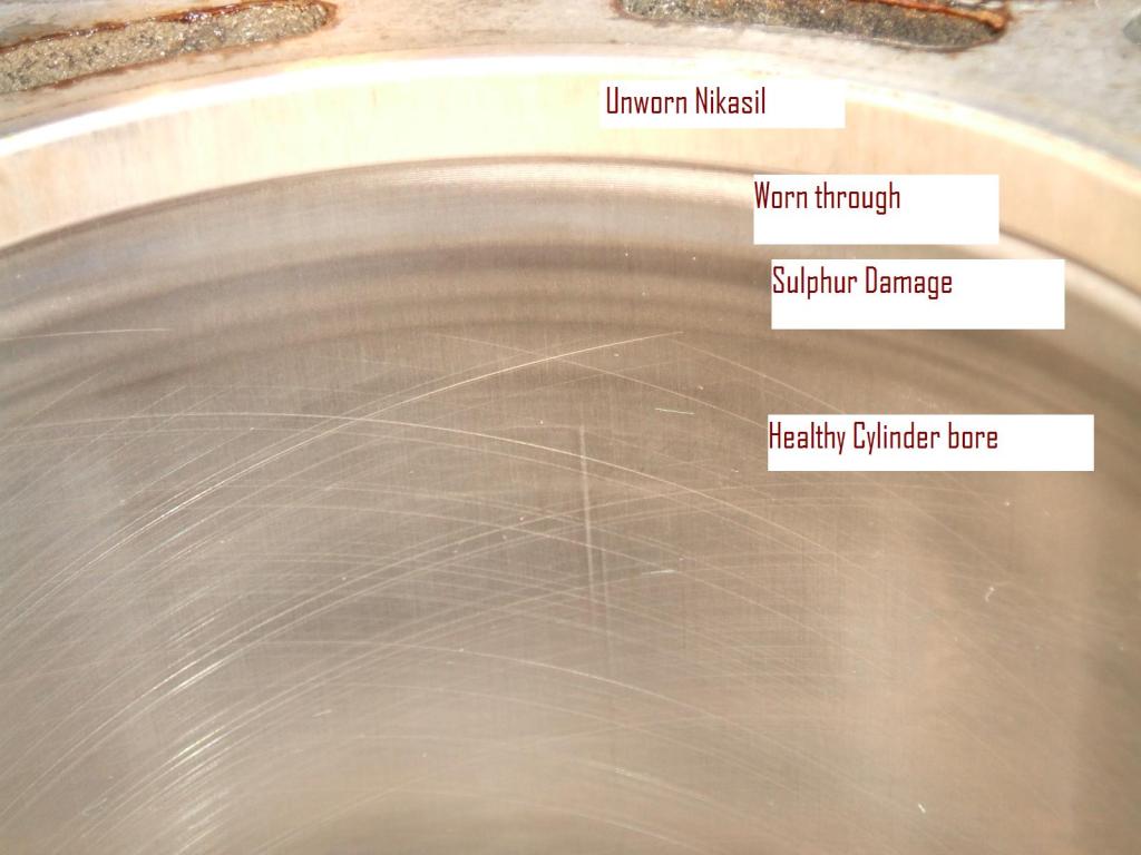

You can hone these cylinders. We've been doing it on dirt bikes for 20 years....but, you are right, too.....
You can hone until the stones wear out and it wont do much except tear up the hone. All you do is scrape off whats on the cylinder and you'll see the original diamond hone marks. Often times, wiping the surface by hand, with atf, did as much as a hone would.
Often times you'd melt a piston and think it damaged the coating. At that point, you'd go in with a hone and knock off the melted aluminum..the cyl looked brand new. You'd drop a new piston and rings in, and thats that....You coudl do the same with our bikes, too. Just no oversize option.
In appearance, it looks like a bad bumper plate job.. Its not pretty. Often times it will have ugly spots, or small pinholes in it...
Heres a pic. http://www.r3vlimited.com/board/attachment.php?attachmentid=51756&stc=1&d=1327948352
You can typically wear out five pistons (with rings) before the coating wore through.
The reason they use it is because its durable, and CHEAP.......No more paying a skilled buy to fit liners. There are other reasons to use it, but high on the list will be low cost.
Its all this for durable, but what it wont handle is dirt. If you get dirt past your air filter, forget it.
Heres how they typically get damaged. This looks like a "four corner" seizure, and they wont stand up to that....But, an iron liner wont , either.
