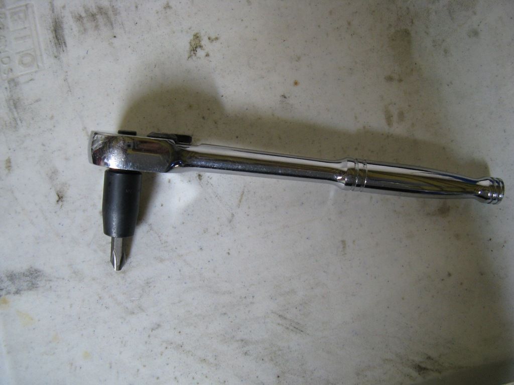

All I did to remove the stock bar ends from my 2014 Ninja 1000 ABS was use a 1/4 socket, inserted a #3 phillips head bit into the 1/4 socket and I was able to bust the Loctite lose. Replaced the bar ends with HVMP stainless steel bar ends that weigh 13.9 oz. each. The weight of the bar ends helps to absorb the kinetic energy that is transmitted to the bars which can over time cause discomfort in the hands. This is a product that I have used on the last three Kawasaki's that I have owned.

I used a #3 phillips bit on a ratchet and they came right off... The adapter and the bit are from my impact driver set.
