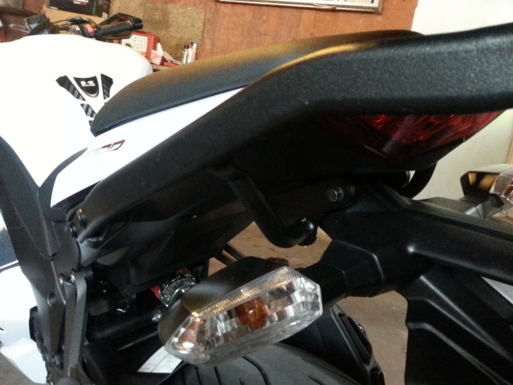

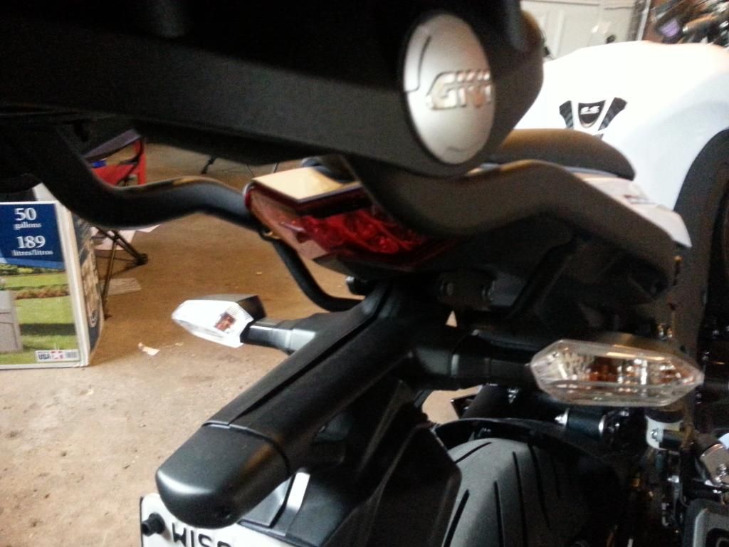

The SW-Motech racks us the same mounting points for the Ninja 1000 11-14 model years. They mount using the supplied hardware using the passenger grab handle bolts, the points on both sides of the bike where the exhaust bolts to the passenger foot pegs and the supplied bracket that relocates the rear turn signals. Picked the SW-Motech racks from twisted throttle.com for $309.99 and the Givi PLX V35 side cases from a 2nd Gear Ebay store in Alberta, Canada for $469.99 shipped. That's cheaper than the $521 to $548 price range I have found in the U.S. , Kawasaki can keep there OEM 28 liter over priced luggage that goes for $1296.00. Robbery!!! That's difference of over $500.00 that I can spend on over things for the bike. I will post a few pics this weekend when I get around to it. Jay
SW-MOTECH Quick-Lock Sidecarrier (Kawasaki Ninja 1000 '11-) Contour Carrier for Givi V35 PLX cases - TwistedThrottle.com
Here's a few pics of the SW-MOTECH racks installed on my 2014 Ninja 1000 ABS with Givi PLX V35 side cases. The SW-MOTECH rack kit comes with plates to cover the holes after relocating the rear turn signals. Installation of the rack system requires you to take apart the entire rear tail section of the bike. I took my time, it was about a 3 hour job start to finish. There is a very helpful video on twistedthrottle.com for the R&G tidy tail kit that goes into great detail on how to take the rear of the bike apart. Very helpful for the SW-MOTECH rack install.

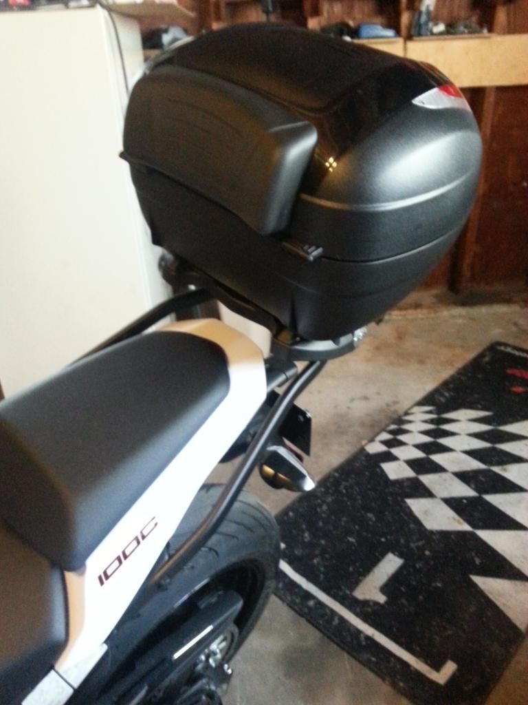

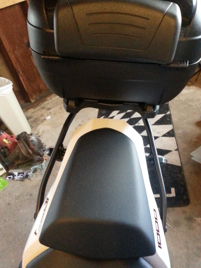

Since others have gone on about the racks for the SIDE CASES, but you were asking about the rack for a TOP CASE. I'll give my opinion on the Givi kit for the top case which I have.
Photos:
The kit you linked is the exact one that I have. But I'm running the B33 Monokey top case. TwistedThrottle or Revzilla would be good places to ask how well that top case would or wouldn't work on your bike with that kit.
The only other thing that you would need is one of these:
-If you go Monolock you need this - Top Case Mounting : M5M MONOLOCK PLATE KIT
-If you go Monokey you need this - Top Case Mounting : M5 MONOKEY PLATE KIT
I took my time, about the install took 1.5hrs, pretty simple, most time consuming part was removing the rear fender assembly.
Hope this helps.
Jay

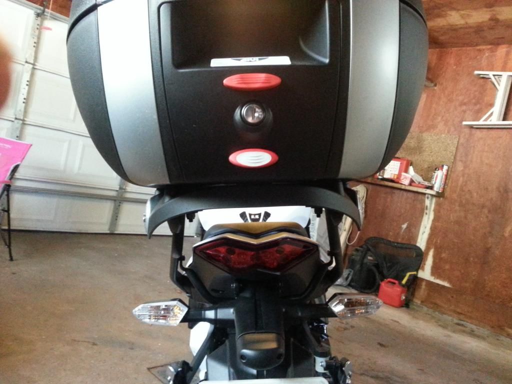

Just wanted to throw my two cents in. I went with the givi fz4100 topcase mounts and the givi easy lock side racks. They are compatible with each other and with patience fit nicely.
Looks good. What's your opinion of the Givi side cases and mounts?
I like the cases. Theyre a hybrid type- semi rigid and somewhat soft. They secure very tightly in the racks.Now the mounting racks look pretty industrial when the bags are off but they are functional.
